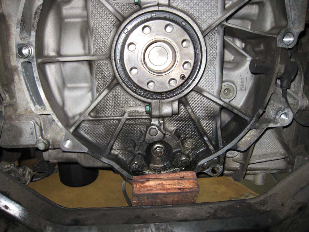

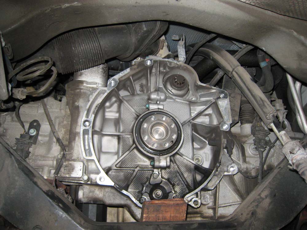

Hi All,
I recently had the RMS replaced on my 2002 base 986 (40k miles) at my dealer that I've been working with for over a decade. They replaced the RMS and did the intermediate shaft gasket. After a week, I noticed the car had the same leak.
The dealer has taken my car back today, removed the transmission and found that the new RMS is fine. However, they have noticed that the new Intermediate Shaft gasket/seal is still leaking. They will replace that gasket again and will also replace the intermediate shaft flange in order to hopefully completely stop the oil leak. They have told me that my engine case is fine as well.
However, is the failure of the brand new intermediate shaft gasket within a week a sign of "pending doom" of the intermediate shaft bearing? Or, am I worrying for nothing? I bought the car at 30k miles. I have changed the oil every 3500 miles, but the records show that the oil changes before my ownership were most likely done at the suggested Porsche intervals.

Hi Jake,
Thank you for your reply.
May I please ask if you would expand on your statement that oil leakage is the first sign of IMS failure? What is actually happening?
Best regards,
Jay
The IMS bearing starts to shuffle as it wears and the nasty oil that has been trapped inside the IMS starts to seep past the center stud and around the outside of the flange housing..
I haven't seen a failed IMS yet that didn't have nasty oil leaking from around the flange.. Change it while you can! When it fails its too late.

the best way to determine if the oil leak is detrimental or not is if the oil thats leaking is a darker color than that the engine has in it's sump.. Compare the leaked oil to that of whats on your dipstick... The oil thats released from the IMS is usually much darker than whats in the engine's sump because it has been filling the IMS tube for a good while and is never released when the oil is changed...
Edited by Jake Raby
Hi Jake,
Thank you for your post! Your last point above is of great interest to me. Unfortunately, I bought the car in November of 2008 and missed the "nose drip" leak that it had at that point. The drip was light brown in color and seemed to be in line with the fresh oil change the dealer did for me upon the sale. I watched the leak all winter and it never changed. This spring, the "nose drip" was still there, still with fresh oil leaking. I decided to have the dealer open the car up and figured it was the RMS.
They changed the RMS and put a new intermediate shaft gasket in. A month later, the same drip appeared in the same light golden oil color. The oil was not tar like or dark brown. Now, the dealer put in a new intermediate shaft gasket and intermediate shaft flange.
So, in summary, my leak has been going on since November (and presumably before that) and the oil coming off the motor has never changed in color. It appears to match the crankcase oil.
Any more thoughts?
Jay

If you have an oil leak from the area where the engine and transmission join - you won't know the cause until you remove the (transmission and) flywheel.
The leak could be either or both IMS and RMS.
My dealer does both the RMS and Intermediate Shaft gasket whenever they open up a M96 car. They can never give a definite answer as to what is leaking until the transmission, clutch and flywheel have been removed.

Correct. In the case of IMS or RMS there really isn't anywhere else it can come out at.
