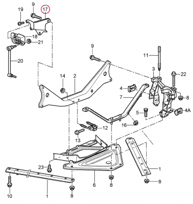

My Mechanic broke a black plastic clip supposedly link to a sensor lever that was hooked to the rounded end of the control arm link.
What sensor is that and it was attached to only one side of the arm. I am trying to replace this piece before he completes the fixing, but I just couldn't figure out what part is it and what does it serve.

If you tell me the item number from the pic I posted I'll look up the part number and price for you...

I think you are talking about part #21 in the picture?
If so, I believe it holds the bottom half of the lever that is part of an angle sensor, which I believe is part of the lintronic headlights.
thanks loren and ericinboca,
the broken clip looks like it's at the position of #21 , but from the diagram, the shape doesn't seem the same. I have attached a photo of the broken clip. it is rounded with an extension on one end. Any part number for this? Is this the clip that attaches the lever that controls the angle of the headlights?
