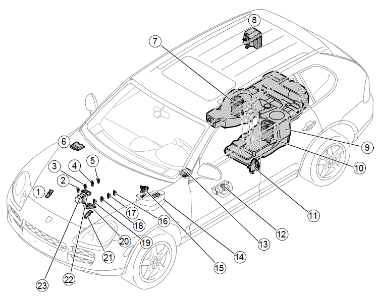

Loren, have you ever heard of a Purge Valve on a Cayenne S. its related to P0441 Incorrect Purge Flow error
Its supposed to be under the design covers drivers side. I cannot see on PET, I admit I am still not used to it tho.

P0441 Fuel tank ventilation system above limit value/below limit value
Possible causes:
- Tank vent faulty (remains stuck in an open or closed position)
- Tank vent installed the wrong way round
- Leak in scavenging lines between tank vent and positive crankcase ventilation (in the Turbo via a T-piece also on the intake side of the turbocharger)
- Scavenging lines between tank vent and positive crankcase ventilation trapped or blocked (in the Turbo via a T-piece also on the intake side of the turbocharger)
1 - Mass air flow sensor, right
2 - Fuel injector, cylinder 1, bank 1
3 - Fuel injector, cylinder 2, bank 1
4 - Fuel injector, cylinder 3, bank 1
5 - Fuel injector, cylinder 4, bank 1
6 - DME control module
7 - Electric fuel pump, right
8 - EVAP canister
9 - Fuel tank
10 - Electric fuel pump, left
11 - Driver's door lock with switch for fuel pump supply
12 - Current distributor with cutoff relay under driver's seat
13 - KESSY control module
14 - E-box in radiator tank with fuse and relay carrier
15 - Pedal sensor
16 - Fuel injector, cylinder 8, bank 2
17 - Fuel injector, cylinder 7, bank 2
18 - Fuel injector, cylinder 6, bank 2
19 - Fuel injector, cylinder 5, bank 2
20 - Tank vent valve
21 - Mass air flow sensor, left
22 - Positive crankcase ventilation heater
23 - Throttle adjusting unit
If you need more troubleshooting info let me know...
Share this post
Is item 20 , the check valve, the one reffered to as Tank Vent Valve ( PET Section 1 107-00) item 13 ?

Item 20 is correct. Carefully check all of the hard plastic lines associated with the valve as they can crack and split where the line meets a fitting. The plastic line is heat shrunk onto a barbed portion of a fitting and that's the most common place they fail.

I've never actually had to replace the valve, the fault has always been a break in one of the hard lines which I repaired with dual wall shrink tube.
