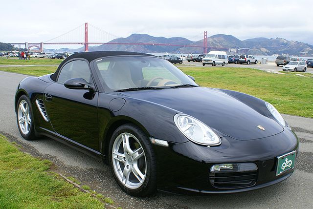

I just purchased a 2008 Boxster w/ 6-sp, PASM, Bose, loaded. The car is being shipped and I take delivery next week (can't wait!).
I diligently searched the forum and many other Porsche forums and have not found the info I am looking for yet. All posts I have read discuss full iPod integration and control with the factory unit. I would simply like to connect my iPod from an Aux Out to either the charge port on the bottom of iPod or to 3.5mm on top. I have a separate cig lighter adaptor to charge it if necessary. I do not need the Dension Gateway 500 unit or any other interface/control type units. I prefer to set the iPod in the dash and use the iPod itself to control - I take it in and out of the car all the time. Does anyone know if the separate Dension cable (for sale for $49 at Bumper Plugs) or any other brand Aux Out-type cable will work by itself without the Gateway 500 box and all the MOST optical connection crap? I'd even disconnect the 6-disc changer and use that port if necessary as I will never bother with the changer. I have the CDR24 w/ Bose and 6-disc in boot.
I also searched floor mat posts and could not find photos of the Lloyds mats or other mats in an actual 987 Boxster. I'l like to swap out my factory sand beige floor mats with black factory mats or Lloyds mats with contrast embroidery. Does anyone know if the Lloyds mats have the same velcro connection to keep them in place? Do they look stock? Any photos!!??
Thanks in advance for all your advice! :D

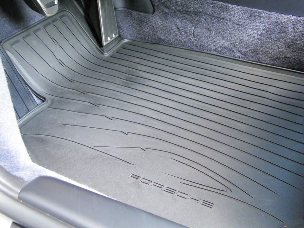

Porsche make a tequipment rubber mat for LHD vehicles. They use the same fixing as the carpet mats and are more durable. Here they are fitted to my 987S.
Thanks. These looks great but I am really looking for a plush black carpeted mat with contrast Porsche logo stitching. Looks like the Lloyds mats are nice but I have yet to see a photo of one IN a Boxster and also curious how they stay in place (velcro, etc.)

Berty, thanks for the pics of the rubber mats. I was wonder what those look like "in person". Those are my list before winter.
