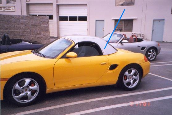

Here is my 1997 silver top on a yellow 2001 with a line to an ear. You can see my car in the background.
