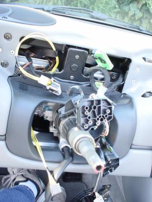

I heard you could not do the OBC retrofit on a 2003 because it could not be turned on.....
The part prices are not bad. The price for the 4 stalk steering column switch assembly has gone up $25 more than I expected, but I guess Porsche needs the money after it tried to takeover VW.
The yellow VW repair wires we use are funny. They were used to fix an electrical problem on an old VW Golf. They are yellow so a mechanic can tell the repair has already been made. Or so I have been told. Someone at VW must wonder why people are stilling buying the wires.
The other part needed is a ring terminal for the ground wire. For wire size 22-18, and a 1/4" stud. They come insulated and uninsulated. You do not need the more expensive insulated version because it is for a ground. I use to buy them at an old time electrical supply place, but it has closed.
Ignore the butt connectors in the picture because those are not needed for 2001-2004.
If someone is interested in only seeing the outside temp display then that can be done with just 1 wire. No need to buy the 4 stalk or any other parts.
