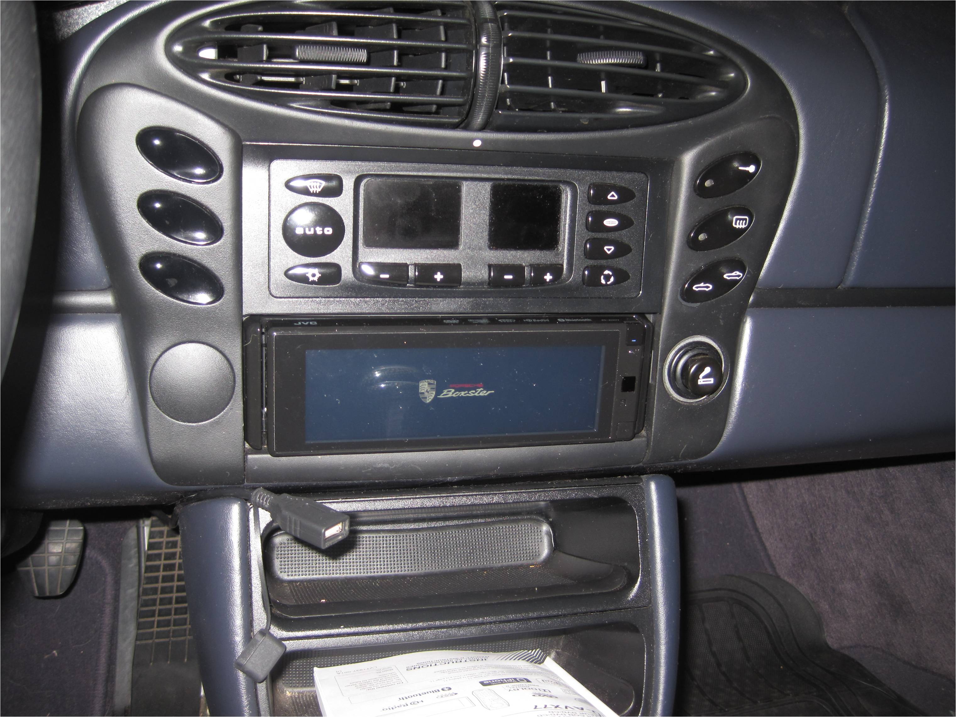

Here it is installed in case anyone was interested.
Its actually a pretty nice alternative to a double din install.
It has everything but GPS. Bluetooth, ipod, thumb drive, plays DVD's, you name it!
Ill probably reroute the USB input into one of the little storage bays.
My apologizes about the dust, she has been sitting in the garage for two weeks now waiting for wheels! And that darn camera picks up every dust particle!
