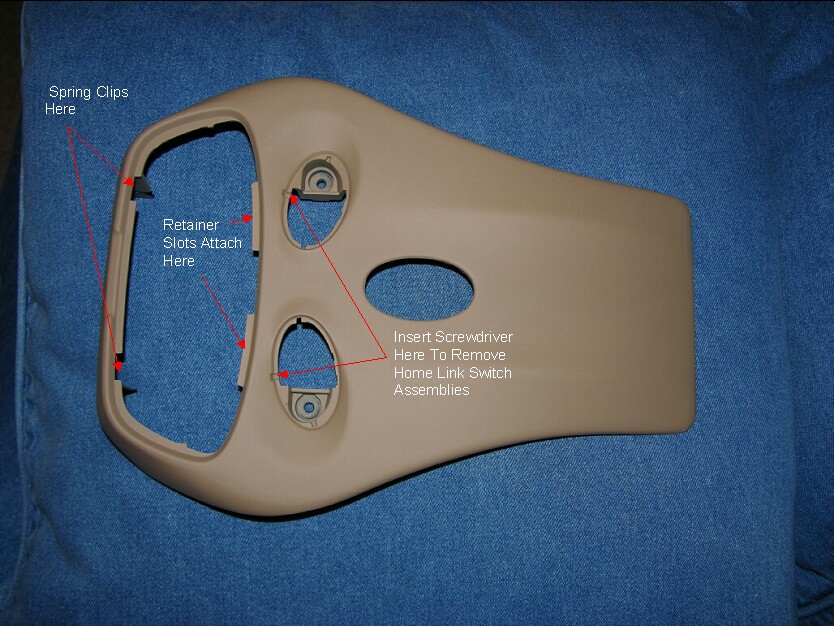

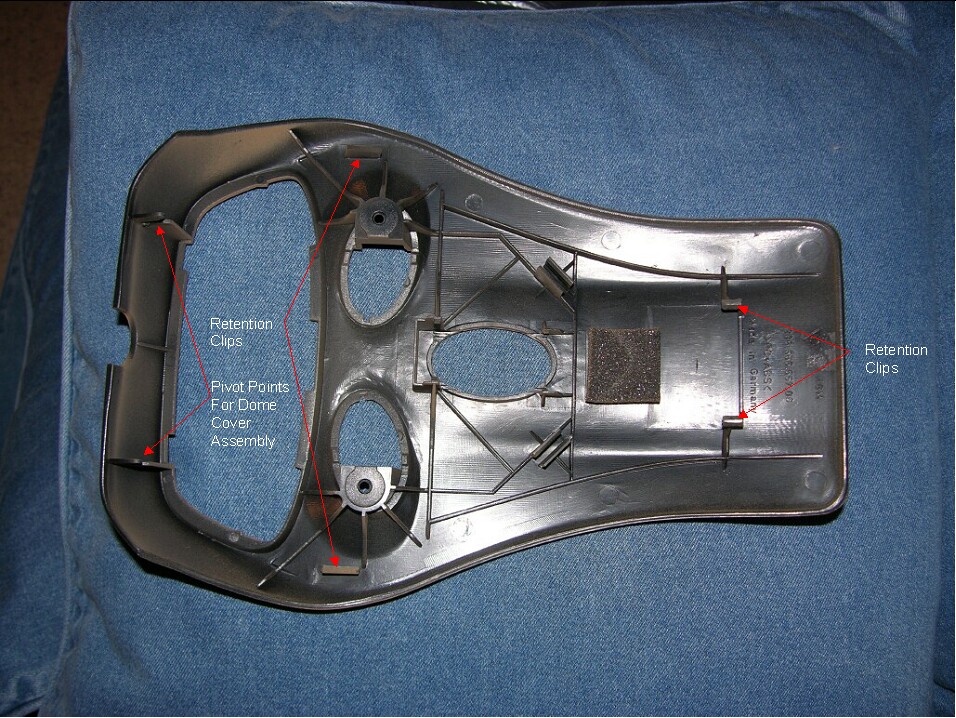

I recently swapped the dome light cover for one in leather. There are no screws retaining the dome light, just two spring clips located next to the windshield side of the light. There are two retainer tabs on the homelink side. Prying from the windshield side will cause the assembly to rotate towards the homelink buttons.
An alternate method is to remove the dome light cover per the method outlined in the manual (see the section regarding manual closing of the sunroof for the coupe model). Removal for the Cab should be similar. You can then access the spring clips of the dome light from the back. Using your fingers to squeeze the clips allows easy removal of the assembly without prying on the lens.
I will try to photograph and upload a picture of the old cover I have this weekend. I will highlight the retention points discussed above.
