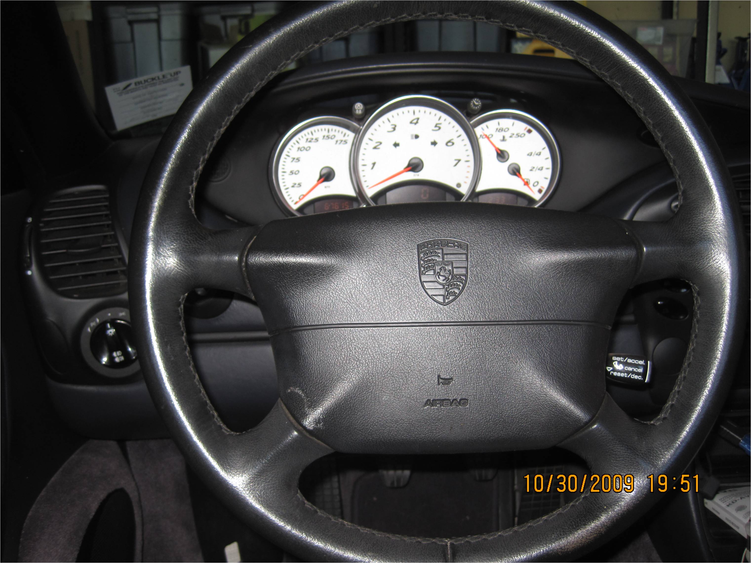

While the car was on stands I did two other things, I removed the factory head unit and amp and installed an aftermarket unit. And I replaced the gauge pod with one from a 2000 boxster S as mine had gotten discolored.

I think it has to be one of two things, either the new gauge pod is somehow setting it off, or maybe there is a wiring mix-up with the new head unit I installed.
In regards to the gauge pod, the light behind the digital MPH readout had burned out, I simplly replaced it with one from the original pod. I cant imagine that would set off a CEL??

Do you think it would be worthwhile to double-check the connection to the gauge cluster?
Kevin,
From what I can tell the gauge cluster seems OK... Everything is functioning on it.
