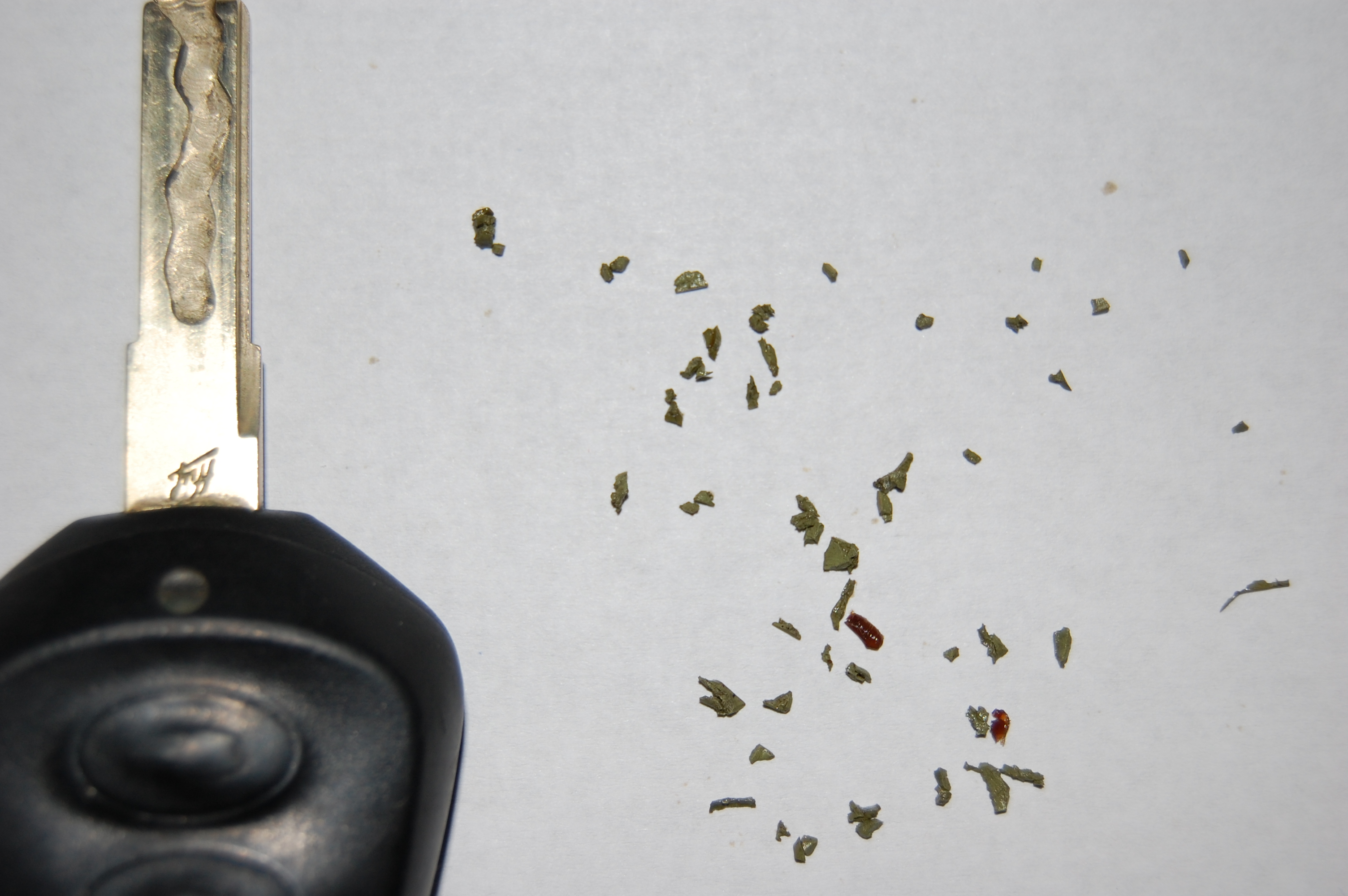

Hello,
I am trying to get some feedback as to what the rubber residue in my oil filter could come from. It is definitely not metallic, it is pliable, has a rubbery feel to it and the color is olive green. It looks like a gasket material.
It started to appear during last oil change 6k ago. My car is a 2000S with about 55k miles and always maintained perfectly.
I thought it might be the AOS but I replaced it and the diaphragm which has the same olive colour was intact.
I was told that when the previous owner had the valve cover resealed maybe they used a green compound but I checked the engine and the gasket material is black.
I am running out of idea where is this coming from?
Please anybody can help?
Thanks in advance
Thanks for the suggestions, I sent my oil filter to Jake Raby let see what he comes up with.
I don't believe the o-rings would end up in the sump.
The chain tensioner a possibility, but I have never seen the material up close is it olive green and very pliable like a rubber gasket?
Thank You.
