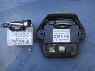

8. If the windows go up to about 3" below the maximum and no further, the microswitch inside the window latch has failed. This is a known problem and about a $3 repair to reseat it.
9. To try this, unlatch the top, and put your finger in the part where the latch hook would catch.
This is the microswitch button. Push it in as far as it goes. Try the windows again. If they work now, your switch is loose.
10. Note - if you feel no resistance above, your switch is entirely loose.
You should feel/here a click when you push far enough.
What is or where is the window latch microswitch? Thank you
