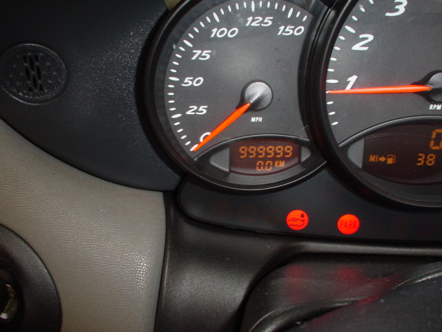

So I guess after a TrafficPro installation this car is a mile away from One Million?
without counting this Million mile car...
No. 1 MrMickeymouse with 137k
No. 2 Scherb with 86k
No. 3 ..........
