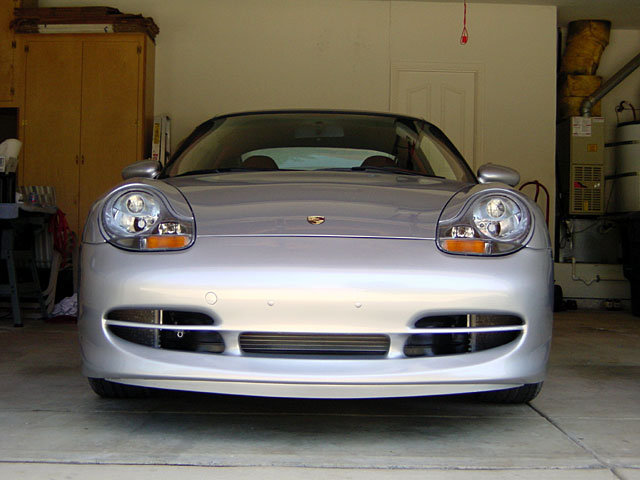

Here is the GT3 front bumper on my car with the plug removed (since I have the 3rd radiator).
