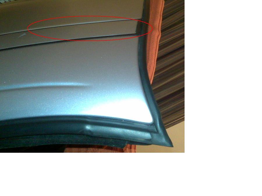

Lift up the cover strip at one end using a plastic spatula and pull it off. The roof strip clips are destroyed when they are removed so you will need new onnes..
Thanks for the info. Wonder if you have the clips p/n.
I may need to order a few before breaking it. This design is a bit scary.

986.563.721.00 Clip -- US MSRP $2.03 each
As I recall there are 4 per side - so a total of 8 clips.
