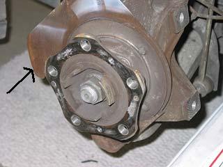

Sound like either a rock in the the brake dust shield or a bent dust shield rubbing against the rotor.
Go to a parking lot, put the windows down, accelerate to 15 mph, clutch in then coast. You should be able to determine where the noise is coming from.

Could be a wheel bearing also, the parts mentioned above are close in proximity to each other, so you may have a hard time figuring it out driving, it would be easier to jack your vehicle up safely and rotate your wheel and check for a rubbing as metioned above, if not it may well be your wheel bearing.
Figures "G" and "H" are the two things metioned above "brake dust shield or a bent dust shield rubbing rotor."

and see figure J or see attached.
You do not have to take off the rotor to inspect the shield just take off the wheel. Once you have the wheel off spin the rotor and see if it makes any noise. If so then look between the shield and the rotor to see if there are any rocks stuck there. Use a screwdriver to remove the offending material. If the shield itself is rubbing use a screwdriver to pry the shield away from the rotor where it is touching.
While the noise could be a wheel bearing in my experience that noise is lower pitched. Wheel bearing noise usually only happens while turning the car in one direction only (assuming you only have one bad bearing). Unless it is really bad it is hard to detect just by spinning the wheel while the car is jacked up. You can also test this by accelerating to 20 mph, coasting with the clutch in and swerving the car back and forth. If you have a bad bearing you will hear it when the car is pitched to either the left or right.
If it is really bad you will be able to feel it if you spin the wheel with the car off of the ground. The wheel rotation will feel rough and you may hear some noise (though you have to be careful as the noise may only be the brake pad rubbing on the rotor). This is not easy to detect if you have never done it before. Try to compare how the left feels versus the right and see if you can notice a difference.
If the bearing is really, really bad then with the tire off of the ground, grab the top the tire with one hand and the bottom of the tire with you other hand. Try and rock the tire i.e. push in with the top hand and pull out with the bottom and vice versa. If you feel any movement or hear any clicking noises then the bearing is really worn and needs to be replaced.
