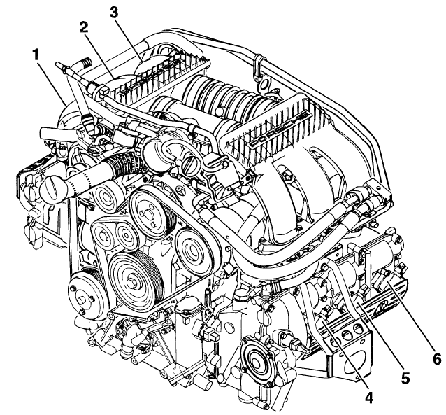

Does anyone have the firing order diagram for the cayman pre-2009? [did a search and only found one for the 997, not sure if same]

987 (as well as 986) and 997 (as well as 996) are the same basic engine - so they will all work.
Remember the engine in a Boxster or Cayman is turned 180 degrees from the 997 series.

to confirm, that'd mean the rear-most cylinder on the driver side.
thank you !
Not sure what you are asking - which cylinder?
Easy way to renumber (at least for me) is that the belts/pulleys face the front of the car on Boxster or Cayman
and they face the rear of the car on Carrera (as well as TT, GT2, GT3).
