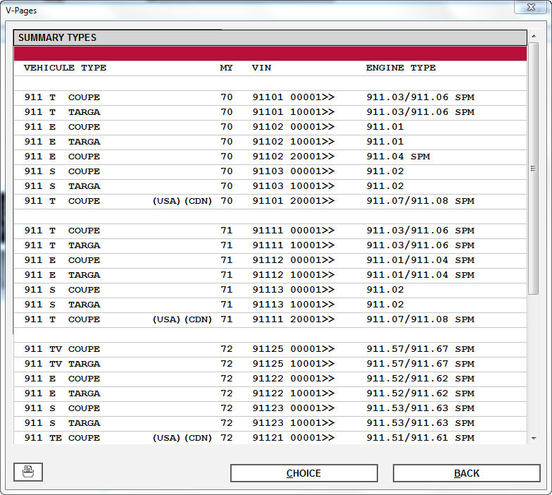

17 digit VINs started in 1981.
Based on the VIN it is a 1970 model.
619 8871 would be a 1970 911T engine - although it is pretty easy to modify a 911 T engine into a 911 S engine.
