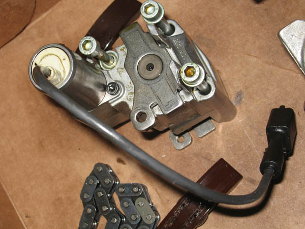

VarioCam Actuator
wvicary-thanks for the info.
seafeye-No, I didnt make that tool. It looks fairly easy to fabricate, but I'm not sure yet if I really need it. As long the notches in the cam line up correctly you should be able to set the timing correctly. I guess I'll find out. I will continue to document the process and share it at www.nutrod.com.
I did both of mine and the only special tool I used was to hold the camshafts in position while the cam cover was removed/re-installed.
I just welded one up and it is nothing fancy, but it works. You can time the camshafts with the timing marks and bright links on the chains.
