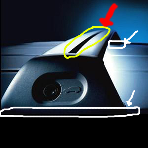

I am not sure I know what you are referring to but I attached a picture of what I have now. I used to have the side rails but I swapped it the transport system. I got it used and all it came with are the 2 bars w/ lock and a key.
Is it the section where the yellow highlight is or the white highlight?
I will hope that the bars are installed in the right direction, the small car emblem on the side (lock) parts should be in the same direction of the car. A little wind noise is normal, but it should not be exaggerated.

Hello - I just found this forum via the Google. Over the summer I bought a Roof Transport System for my 996 and I'm getting ready for my first ski trip with it. First test drive it whistled like crazy - just an unreasonable amount of noise. It started whistling at around 30 mph and at speed It sounded like I had a dozen boiling tea kettles on my roof. I did check the orientation of the racks as suggested by RFM, but that wasn't it.
I do have the rubber strips that came with the cross beams. The ski carrier instructions make no mention these rubber strips at all. I guess you're supposed to chop them up into segments to fill the voids in the cross beams, but I'm a little reluctant to do that. Eventually I want to get a road bike carrier also, and I don't know if the gap lengths would be the same, and I haven't yet checked to see how available those rubber strips are.
So for now I've covered the slots with gaffer's tape, and it eliminated about 90% of the whistle. There is still some noise from the ski carrier itself, but that's to be expected.

I have found that the whistler noise in a proper installed roof transport system comes from the bar upper grooves. This noise is much increased when you install the ski rack over the bars. The solution is to install the provided molding rubber bar in the groove. If you have installed the ski rack you need to install a shorter rubber piece between the two ski rack support. In my case this solved the problem.
