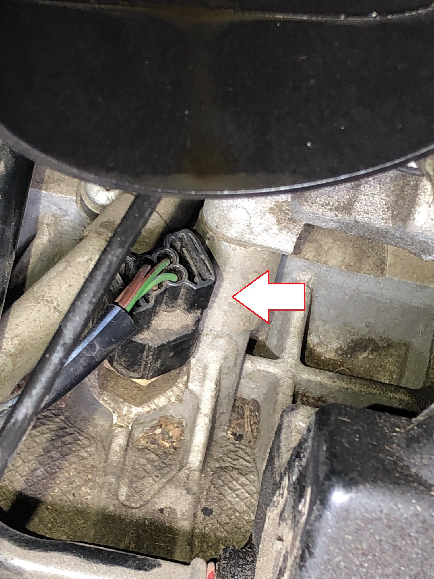

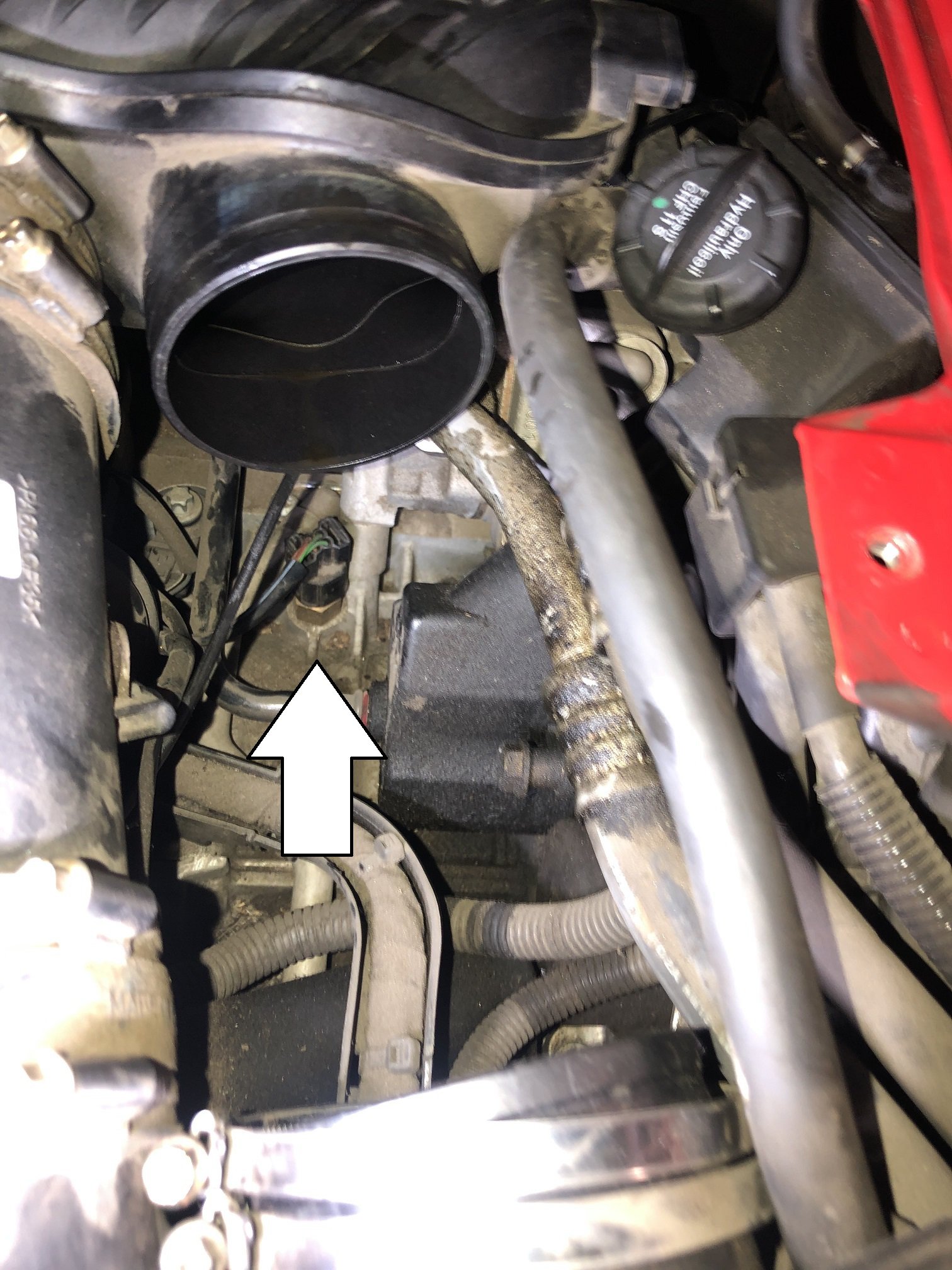

Yes, removing the sensor does appear to be a challenge.  I've removed the front cold air intake plumbing and can clearly see the sensor but it's buried way down there and will be very hard to get a wrench onto...let alone turn it.  The top of the sensor is a plastic connector and is larger than the metal hex part used to remove it.
If the manifold has to be removed, I'll probably 'say uncle' hand the job over to one of the local shops.   Thanks for the diagram.

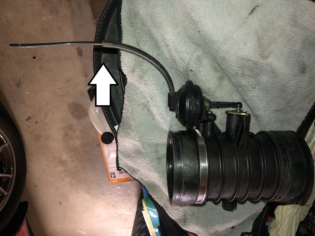

Anyone know where and how this hose gets connected.  See arrow in the pic... will be very difficult to reattach w/o removing the left intake manifold - if I knew where it goes.   Any diagram, guidance or suggestions appreciated.
Thanks for the help.
