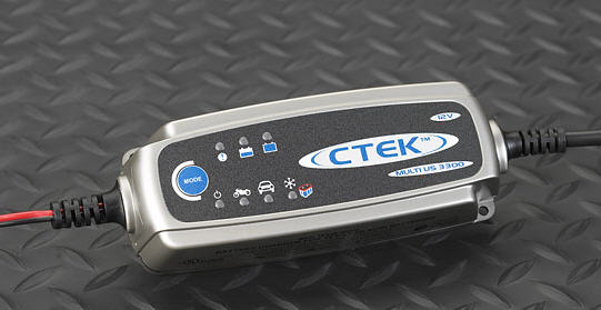

Hi -- I bought the CTEK model 3300 ($70) at crutchfield.com. For $10 more you can purchase the cigarette adapter -- then you will have exactly the Porsche OEM version and can charge your battery (one or two if you have that option) via the cig adapter. Some people purchase an adapter for each vehicle they own and leave the adapters plugged-in.
Our Cayenne S is mostly a daily driver but often it's stop and start in heavy traffic using the radio, AC, lights and electronics -- not a lot of time spent at high speed/freeway RPMs which is key for battery charging. My monthly routine may be overkill but it's so easy I just do it and it may be extending our battery life. Once I'm in our garage I crack a window (passenger door), plug it in one of the cig adapter jacks under the glove compartment and am good to go.
I also do this for our VW GTI, my mother-in-law's X5, etc. Can't hurt. I always plug it in the Cayenne if we travel and are away for more than a few days when I know it will sit unused. The CTEK's cycle off and on and will not damage the battery -- unlike some trickle chargers which can cause damage.
One note, I always keep the unit itself on our cement garage floor -- it gets hot and I do not want anything too warm left in the vehicle. The cord is long-enough to go from the cig adapter out of the window to the CTEK unit on the floor, then the unit plugs into the wall or a heavy-duty extension cord. Sequence is this: 1. plug CTEK into car, 2. plug CTEK into wall current, 3. turn CTEK unit on. The LEDs will go from red to green to let you know the cycle is complete.
And as Loren and others have noted, it's hot weather that really strains batteries, not just cold.
A really helpful use of the CTEK unit is sometimes when I'm in the Cayenne with the engine off experimenting with settings or radio pre-sets or whatever I have the CTEK plugged in so I don't drain the battery. And when the time comes to physically change your current battery(s) for a new one keep the CTEK plugged-in so all your settings are not lost.
Attached are pics.
