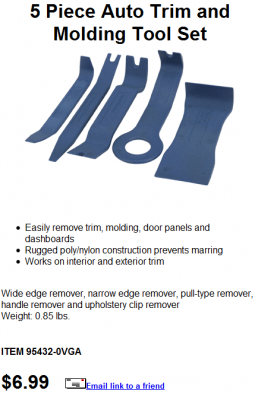

Lift from the front of the car to the back (kind like hinged). Use protect cloth and plastic trim tools to prevent any damages.
