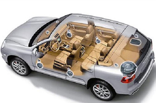

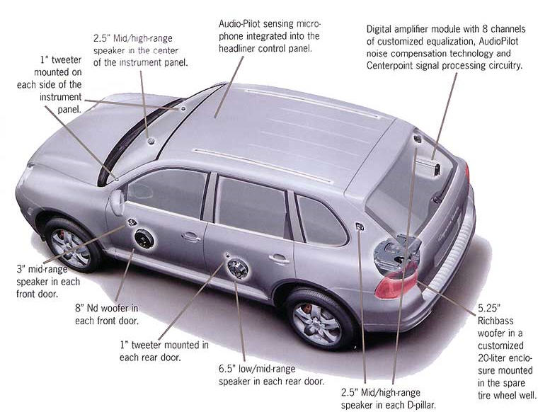

Edit (add two pics).
The attached pics cover Bose configurations but will give you an idea of speaker locations and count.

For the speaker question check your owner's and PCM manual and, as also earlier noted, keep in mind some grills cover more than one speaker. If this is making you crazy then go to a Porsche dealer and talk to them.
