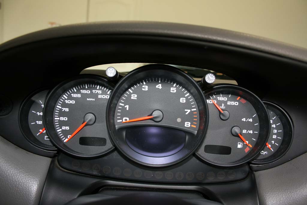

I have a real problem relying on "idiot" lights and want to install additional gauges in my 2001 Boxster S. I have found that Autometer Ultralight II gauges have a relatively close font and illumination look to the stock gauges. I have located a DIN standard 3-gauge mounting bracket that fits directly in the slot occupied by the CD holder. I want to add 12 VDC, Oil Pressure, and Oil Temp in the three positions in the bracket. +12 VDC power and illumination should be easy to get from the radio, but I'm a little unsure about oil temp and pressure. Oil temp could and probably should be obtained from a new bung welded into the oil sump. Is there a better or easier location? AS for oil pressure, there is the possibility of (a) using a metric adapter to replace the existing sensor which will result in the dash light to not work, or (B) possibly locating an adapter and sensor in the oil pressure test location.
Since I am not using vdo meters (only because they don't make one to match the existing gauges) I cannot use the existing sensors and will, as mentioned, need to have metric adapters that can couple to standard Autometer sensors.
Has anyone done this before? Is there an easier way to do this?
