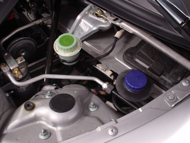

All I know is that the turbo has a power assisted clutch. There is a separate reservoir for the clutch, but it uses Pentosin power steering fluid, not brake fluid. The reservoir for the power assisted clutch has the green cap, which is next to the blue cap for the washers. You have to remove the plastic cover next to the battery to get to the green cap.
I have a turbo owners manual and it does say to check the dip stick in the engine compartment for the power steering and clutch. I assume the power steering pump is also for the clutch. No clue why there is also a reservoir in the front of the car. It is not mentioned in the owners manual.

The car spent the day in the shop, no leaks found. The level of fluid in the front green capped reservoir was okay. The level for the power steering/clutch (?) was low and topped off.
I didn't get a chance to ask about why the manual says to check the engine compartment dipstick when the clutch reservoir is in the front.
The clutch is easier to push in now, either that or my left leg got stronger.
