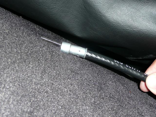

Take a look at the outer black vinyl covering on the two drive cables that lead from the sides of the electric motor and go in an outboard direction around the back wall of the convertible top well.
Are those cables smooth or is there a cross-hatch pattern on their surface?
Here is what each of them looks like:
Cross hatch pattern cable
Smooth-sided cable
