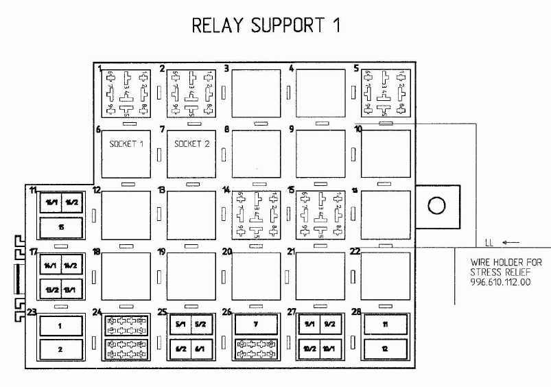

where are the relay's location Loren?
19 RADIATOR FAN 1 STAGE1 141. 951.253.B
20 RADIATOR FAN 1 STAGE 2 141.951.253.B
21 RADIATOR FAN 2 STAGE1 141.951.253.B
22 RADIATOR FAN 2 STAGE 2 141.951.253.B
Loren

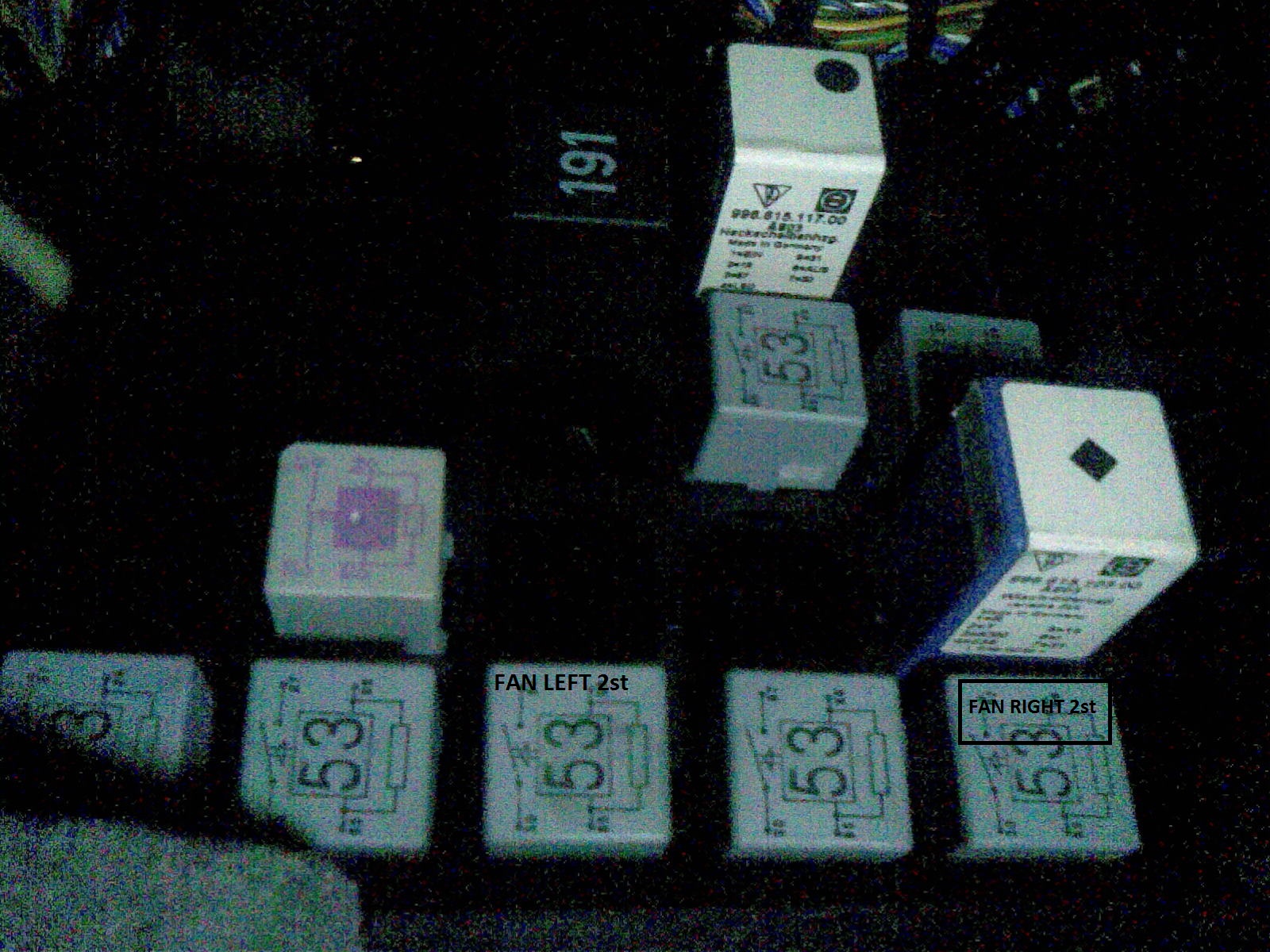

the relays panel look kind of different that the schematic you give.maybe because it is an german model.
i have checked all the relays,they work fine.could you please advice where are the water temperature sensors wich send water temperature and activate the fan's.both of them the one for stage 1 and the other for stage 2.thank's

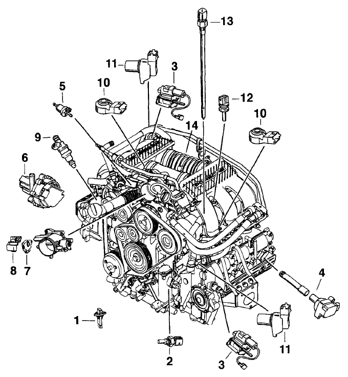

Loren where is the sensor that send this command,because i don't think that the ballast resistors do that i guess that this sensor it has to be actually in the water to report the accurate temperature.this faulty sensor is the only think i have in mind considering the test's we've done but this is also bizare considering we have no related fault codes.very anoyng

"The engine temperature sensor is a double NTC, i.e. there are two resistors in the sensor housing. The plug contact is new.
One temperature resistor (resistance can be measured between contact 2 and 3 in the plug housing) supplies the signal used to display the coolant temperature on the instrument cluster. The other temperature resistor (can be measured' between contact 1 and 4 in the plug housing) informs the DME control unit of the coolant temperature.
The signal from the temperature sensor is used by the control unit
• to calculate the injection signal during the warm-up phase
• to enrich the mixture when the engine is started
• to determine the ignition angle in the warm-up phase
• to control the electric fans.
The engine temperature sensor is located in the coolant duct housing." Item 2 in the diagram below.
i will check it in the next hours,what i should measure?the resistance?wich is the corect value? do you think it can be his fault?there are no fault codes after all..
