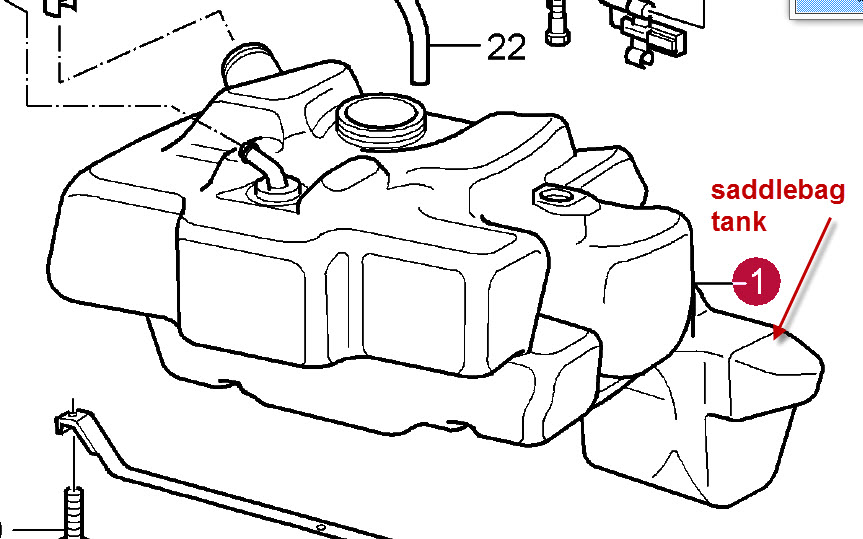

C2/C2S gas tank is different from the C4/C4S gas tank.
In C4 it is a saddlebag tank with one part on each side of the front wheel drive - and the fuel level is only on one side.
C4/C4S fuel tank

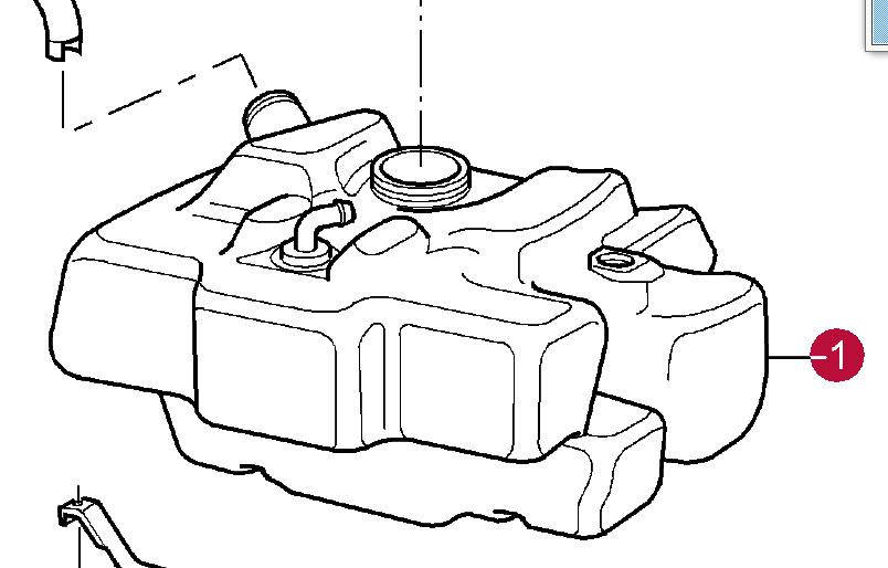

C2/C2S does not have this issue as it is all one tank.
C2/C2S fuel tank
So, I think you may have another issue. Best to put Durametric or a PIWIS on the car and see what is really going on.

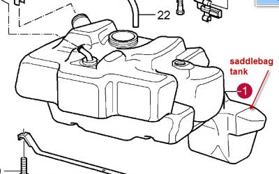

C4/C4S fuel tank
C2/C2S fuel tank
