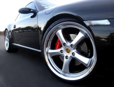

I had the Turismo 20's on my 997. The Victor wheels are very well made and look great. Just be aware that they are going to be heavier that your Stock Porsche wheel (which will effect your handling.)

I have Victor Equipment Turismo on my '00 986 S.
8x18" front and 9.5x18" rear (ie the boxster fitment they offer..)
I wouldn't mind a bit more aggressive offset but for the money these are OK. Worth noting it says "made in China" on the back.. but absolutely no problems for normal use and I've been to the track a few times as well.
