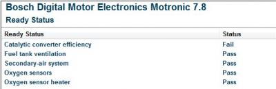

I just ordered a Durametric to check out why my car (05 996 Turbo S, FVD Flash & Exhaust) is only see .5 bar. No faults or CEL, but on under the Durametric "Ready Status" it shows "Catalytic Converter Efficiency - Fail". Anyone have an idea what this might be?
Thanks

I'm not familiar with the Durametric diagnostic tool.
But.. can I ask under what conditions you ran the test.
Catalytic Converters don't run under optimum efficiency
unless they are very hot.
Your efficiency test will be a measure of this.
Yes it true, that the O2 sensor will become less
efficient long before being indicated by the CEL.
You may have a better idea as to when it was last changed.
