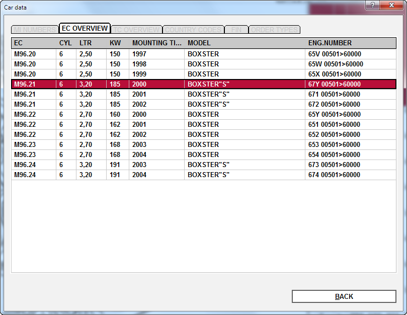

I believe that 66Y designates the MY 2000 3.4L
66Y would be a MY2000 Carrera engine if the first code was M96.04.
The original poster says his first code is M96.21 which is a Boxster S engine code.
Is this a Boxster - if so you posted in the Carrera section.
M96.21 67Y is a Model Year 2000 Boxster S engine. 3.2 liter 252 HP.
Interesting. This was supposed to be a 3.4.
