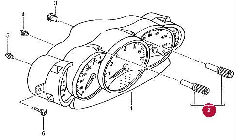

Finally, the cluster showed up without the two "pegs" used to re-set the odometer and adjust the clock. How can these be replaced?

Do a search here for the cluster knobs - there is a guy that posted here that he sells them.
If by "pegs" you mean the shafts that go into the cluster assembly, check this out:
If you mean the actual knobs with which you twist the shafts that go into the cluster assembly, then Richard has your part number.
