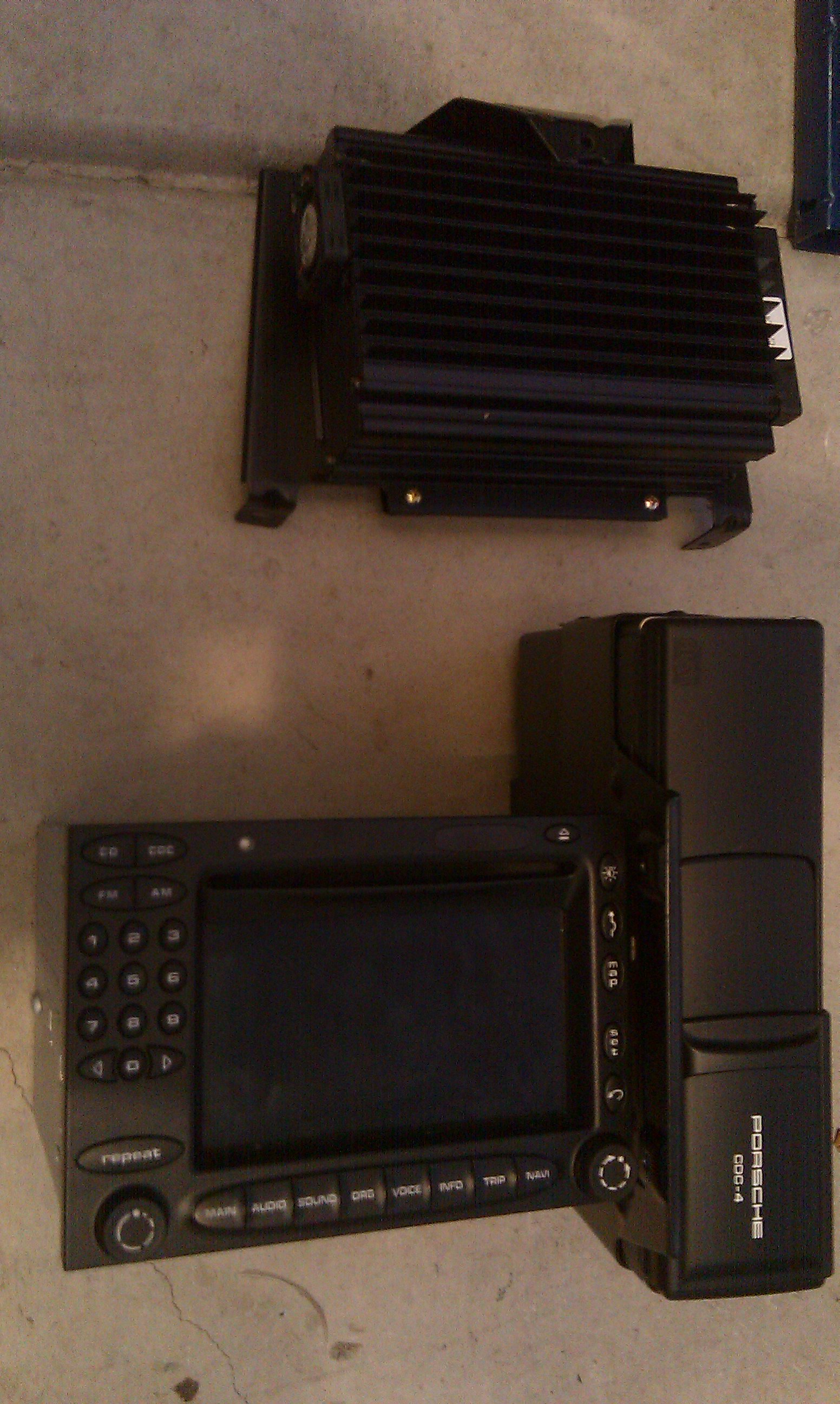

Thanks - I ended-up pulling the PCM altogether yesterday since I wasn't convinced getting the update / maps would really be worth it in the long run so will go the after-market route instead.
post-49229-0-67068600-1289668078_thumb.j
