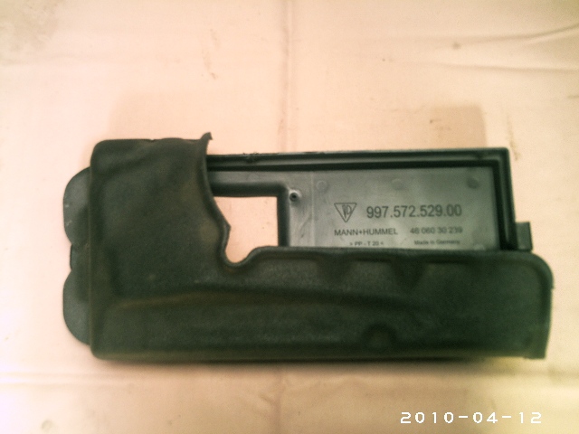

Hello everyone,
I have a problem on my Carrera 3.6 of 2005.
After washing, the windshield fogs up in an unusual way.
I found that this happens because the absence of the cover of the pollen filter.
This part has been forgotten or lost, in the past during a service.
May be they have forgotten to put the part in its place, it's so important because the particular function.
The filter absorbs water and transmits the steam in the cabin and must be replaced because loses its shape.
In practice, on my car, after removing the filter compartment cover, the element appears directly instead of the grey rectangular shaped cover (as shown in attached photos).
Please could anyone tell me the part number of this cover.
Could anyone kindly checks on his Carrera because I didn't find it on my PET file.
Unfortunately last week PCS ordered a wrong part (external cover) so my problem wasn't solved. They have misunderstood what I needed.
Thanks.

Hello,
firstly thanks for your initial help.

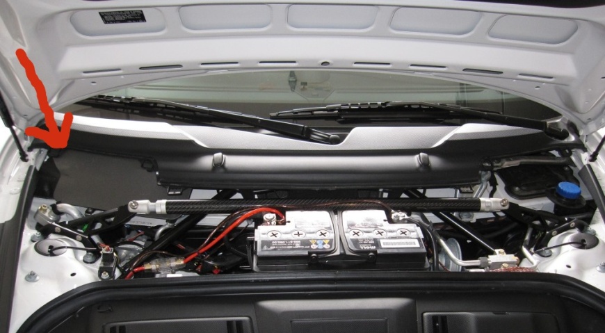

Please note that photos do not show my car.
I've found them in internet so I used because they show the missing part.
The missing part, is the gray plastic cover indicated by the red arrow on the first photo. It is better enlarged on the second photo.
I would like to know its part number as well as the part number of the pollen filter housing.

My 2006 does not have a cover and looks like
your first picture, but missing the plastic covers
like I show in the picture I posted.
The picture I showed is a 2005 USA car. I looked for
your part number but I could not find this part.
Maybe some parts supplier in Italy can help you..

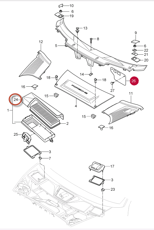

Did you ever find the part # for the thin foam cover? It's not listed in PET or anywhere I can find. I ordered a new cowl panel and it didn't come with this!
All your covers are missing - including the one over the battery and the brake booster on the other side.
The strut brace is why - someone put it on the car and took all the covers off because they don't fit with the (useless in my opinion) strut.brace
Loren - do you have any idea where I could find the part # for the foam cover (as seen in the first picture by the OP)? I looked in PET and can't find it listed anywhere! The part itself doesn't have a number., I ordered a new Cowl panel and it was not attached. Apparently it's quite the elusive part! Did Porsche forget to list this part maybe? Of are there ancillary parts that just aren't in PET sometimes? Mine is torn and I'd like to replace it along with the my new cowl cover. Thanks!
As far as I am aware the foam cover was part of the bottom housing on some models. So it is not a separate part.
If you go to a dealer and ask to see 997-572-019-04 housing you will see what they sell today (US MSRP $68.08)
Thanks for the quick reply. I was referring to the thin cover/flap that covers the cabin filter that is attached to the cowl. I found part # 997-572-763-00 in PET called "cover", thinking this may be the part I'm looking for as the Pos is "-" which I now know means it's not pictured in the illustration".,,
The part you referenced (997-572-763-00) is item 26.
From what you are saying you want item 24? (997-572-729-02 Cover -- US MSRP $59.12)
No, that's it, #26! It's not pictured on the USA/Canada PET (06.02.2010) version I have. Where did you find that illustration? I'm guessing its a ROW version since it shows in on drivers side? I'd like the tabs #27 too if you have the #....awesome, thanks!
