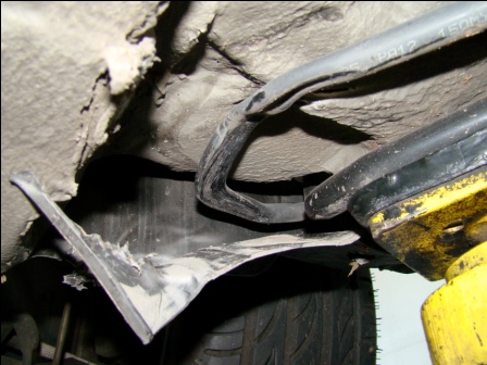

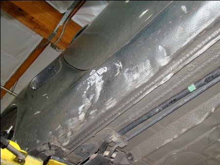

The bad news: I hydroplaned on oily/gasy pooled water on the way to the shop going about 10mph while making a left turn after a stoplight. The car skidded up over a median filled with bowling ball sized cobbles (insert sound of crunching metal here) and plowed into three lanes of oncoming traffic. Fortunately, the rocks slowed us down so that the cars were able to stop in time (a PT Cruiser was less than an inch away when we both finally came to a full stop.) I managed to drive the car off after exchanging insurance and am waiting for the insurance company to decide whether or not to total the vehicle.
