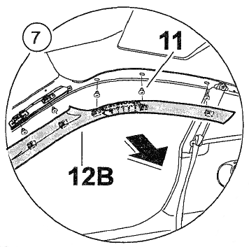

There are quite a few post on the above topic which are only applicable to cabriolet.I need instruction on removing the covers on the A pillar(this is for 996 coupe).notice this piece goes all the way back just behind the frt seats.There is a clip on the defroster strip which fit underneath the A pillar n as such the cover on the A pillar needs to come off.Appreciate your comments.tks
its a 2003tt,i am changin the defroster to cf.(where the windshield meets the dash)tried to take the defroster strip but it will not detach completely as i notice there is a clip that inserts into the A pillar at the base .cant seem to figure out how to dismantle the A-pillar?your help is appreciated.tks
Pull the A-pillar trim inwards along the roof frame and windscreen frame. The A-pillar trim as of MY2000 is characterized by a changed curvature and the notch for the deformation element.
Before installation, check that the deformation element is seated properly. Check sheetmetal clips and replace if necessary. Insert the A-pillar trim at the side of the windscreen frame (transition point to dashboard), clip in the A-pillar trim along the roof frame.
