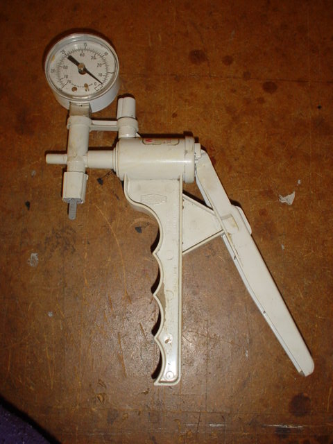

TP, I'm getting the local OPC to inspect it tomorrow. the thing is that these rods appear loose on mine and offer liitle resistence hence why im thinking they have been damaged. I havn't got one of those tools so its going to be difficult I presume anotehr way of testing is pulling down on the rod and to see if you get the gas flow re-direct.. ?
I'm trying to replace one of these vacuum actuators on my 996. If you don't want the quiet feature, you don't need these. If anybody doesn't want the quiet feature and would like to help a fellow p-car owner out, I could send mine for trade. It's the part that bolts on and includes the rod. :D :D
