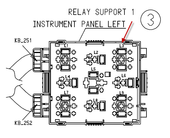

No, good suggestion.
Under the dash drivers side I assume - can you identify the relay that runs the power for the compressor for me? Or is there an resource that I can use to identify it for myself?
Mark

I exposed the relay in question and saw that it did trip when the car was started. Then I tested the circuit itself, and it had no power. That is when I remembered that there are a few additional fuses under the seat beside the battery. And that is it - the 40 amp fuse under the seat was blown. Replaced it and the compressor charges the system immediately and I am back to normal.
