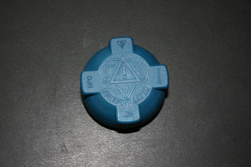

If it does not have the Porsche part number on the cap - it is not a Porsche part. Some dealers were using VW caps when the -00 caps were all leaking in 1998 and 1999. My dealer did and I replaced it with a Porsche cap a year later.
This is an -02 cap but you can see it has the Porsche part number and the Porsche parts logo.
