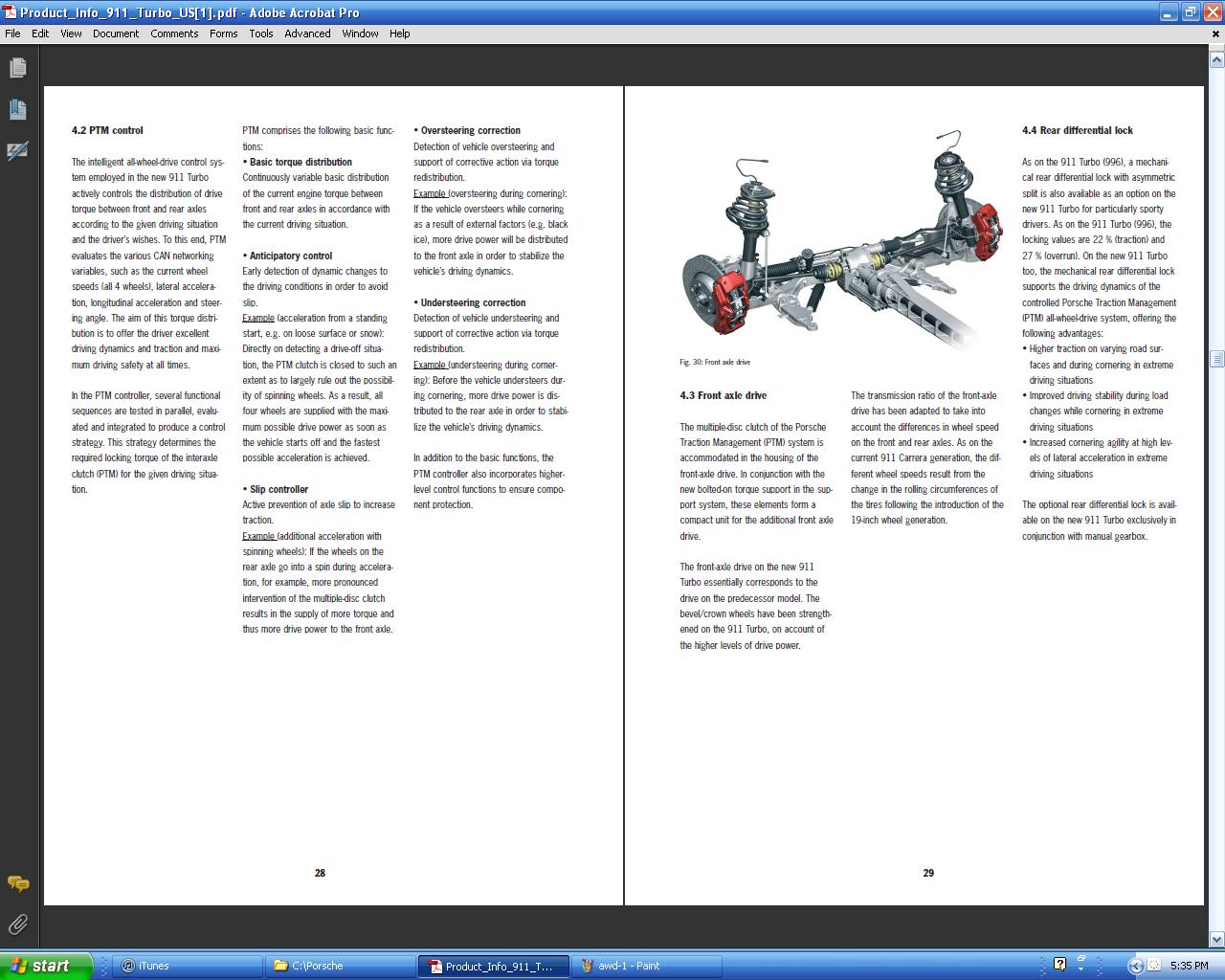

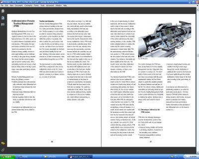

The PTM transmission explains the difference compared with the
996 Turbo. Sounds like the Porsche Engineers solved
the problem for the 997 Turbo.

If you want more than 5-10% of the engine torque routed to the front wheels of a 996 or early 997 then the procedure is to drive agressively in a tight circle about 10 revolutions. With that much sustained disparaty between the F/R driveline rotation speed the VC will "stiffen" long enough for the average road course.
The newest 997 now has an actual functional R/awd system using the same electromechanical clutch setup Ford has used, pretty much UNSUCCESSFULLY, in the Escape and Mariner. Now in use in the new FWD or F/awd 2011 Ford Explorer (yes, that says FWD & Explorer) but with water cooling of the PTO. With the C4S being R/awd the problems Ford has had are unlikely to affect the reliability of the Porsche version.
