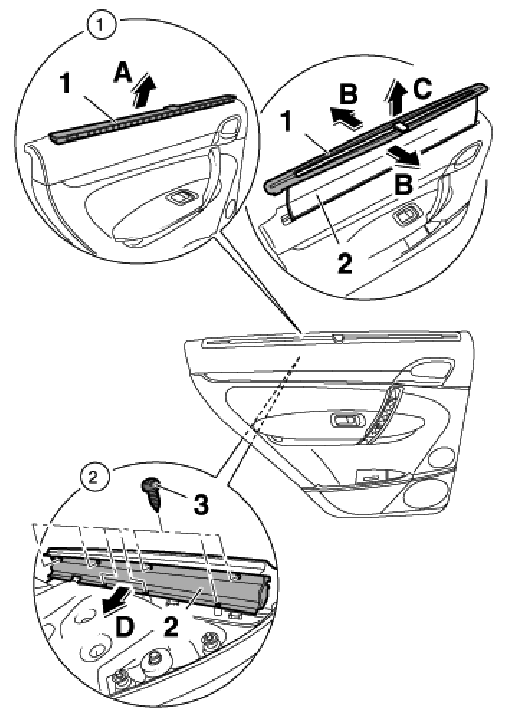

Any DIY for replacing the roll up shades on a 2004 Porsche cayenne S my daughter finally got the best of it and ripped it. The tear is at the top part where the shade hangs on the door hooks. I don't know if it can be fixed the tear is at he very top next to a metal rod that is housed in the plastic casing that hangs on the door hooks. Also where can I get a replacement part I checked sun coast's website and didn't see them I found one on ebay $140.00.

You will need to start by removing the rear door trim, I think that is covered here elsewhere.
Removing cover
1. Unclip cover 1 (arrow A).
2. Open up cover 1 (arrow B and remove above the sun blind on the door window 2 (arrow C) by pulling the sun blind on the door window 2 out slightly.
Installing sun blind on door window
1. Position sun blind on door window 2 (arrow A).
2. Screw in fastening screws 3.
Installing cover
1. Open up cover 1 (arrow B and guide into position above the sun blind on the door window 2 (arrow C) by pulling the sun blind on the door window 2 out slightly.
2. Clip in cover 1 (arrow A).
Replace door panel trim.
