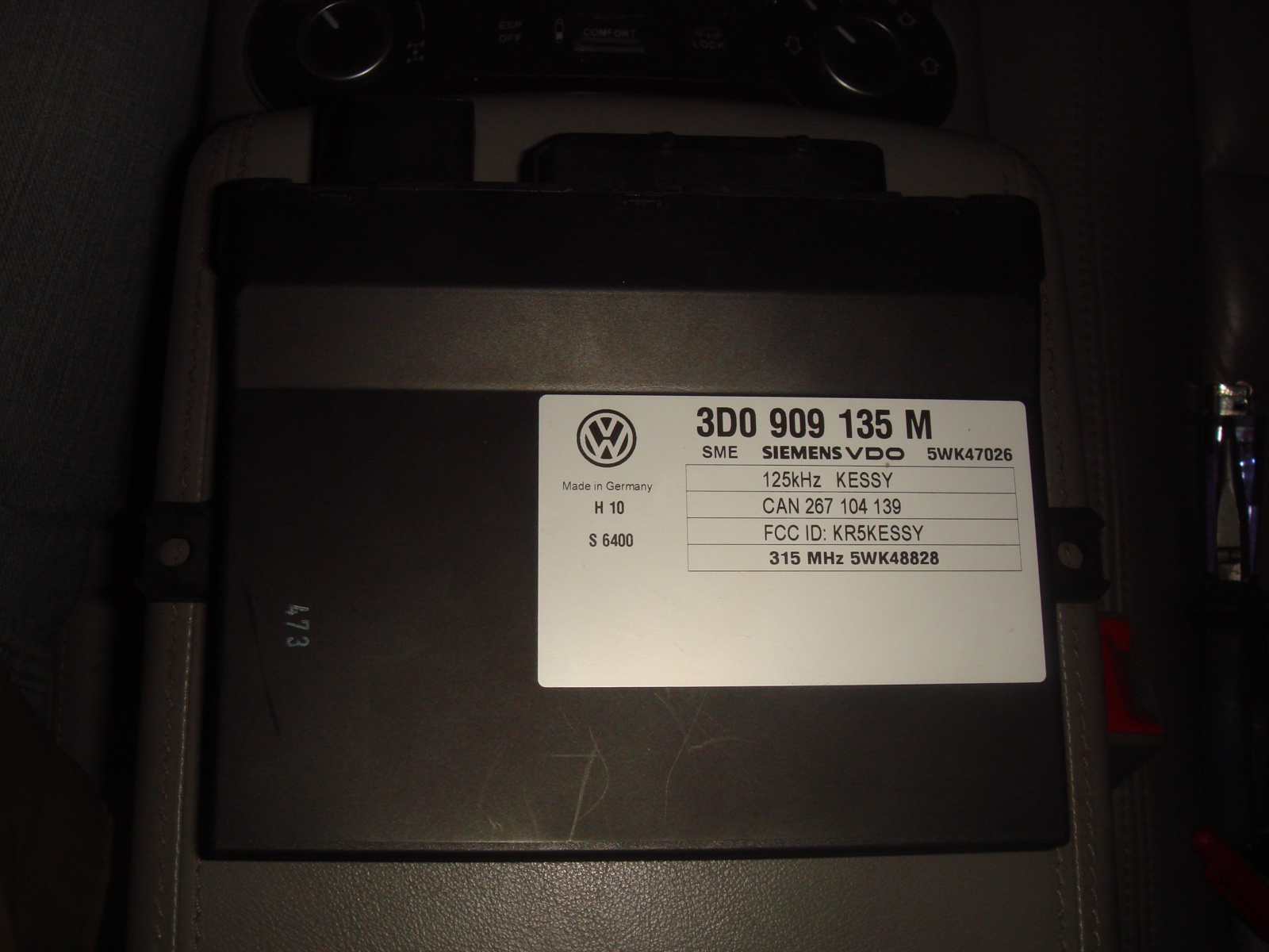

I was investigating myself trying to see what causing the problem, I came in to the touareg forum and found out those guys there have a lot of the problems with their module too. ... I was like ,hum.,,. then go under my dash and found the kessy module that is EXACTLY the same as theirs including the part number (WHICH IS A VW part number stamped on a sticker btw)....

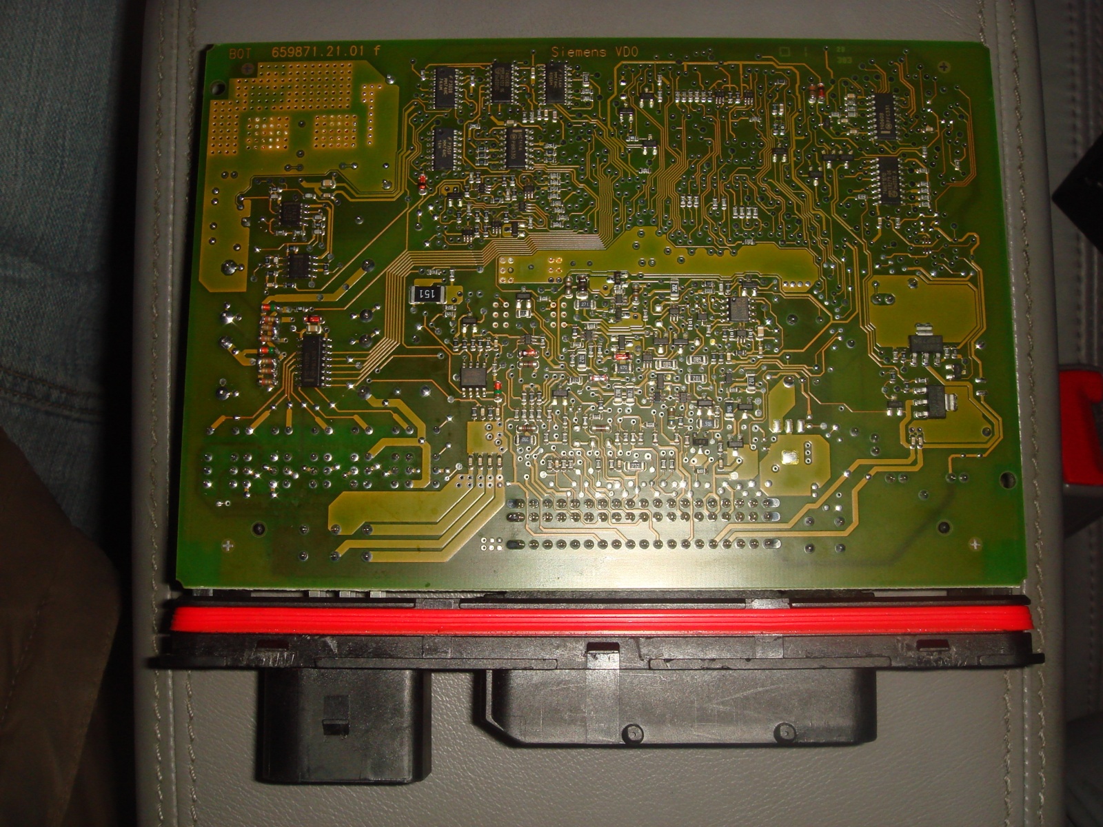

there is one guy there that took his module to a local electrician and found he has 2 fried mofset and 6 fried resistors.!!!

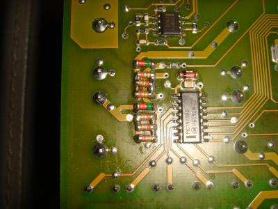

I was like, fxxx it, why don't I give it a try, at first I couldn't found the 0.22ohm resistors (its was HARD trust me I took almost 2 months looking for them)., so I went ahead replaced the two mofset........... 15 mins and a lot of smoke later....... MAN,,,... the module can communicate with my Durametic tool...! HOWEVER,, all the antennas are reporting short to ground ERROR!!! I tried to clear it but the code come back instantly.
then I went on to test the resistor value,... and found all six of the 0.22ohm resistors are SHORT (they are fusible resistor btw)....,,. sooooo I tried my best and finally able to locate those 0.22 ohm resistor ..,
fast forward 2 months later............ I received those resistors today.............. another 15 mins of smoke and sweat with my resoldering station... I plug the module back... run the scan tool clean the fault codes!!!!...................

NOTE: IF your kessy don't communicate with the scan tool,. Its the TWO MOFSET that is Fried.
if you have all antennas short to ground or not responding its the 6 resistors!

Hey Timmy, any chance you can recall your source for those $5 parts? Please!! And maybe indicate on the pics which parts you replaced?

FYI...these resistors sit across the drain of the transistors, if the resistors are blown, it's because one of the mosfets is bad.
Translation, replace everything at once (2 transistors and all 6 resistors.

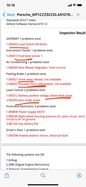

Ok so all my antennas are short again! The PIWIS is able to communicate to the KESSY module and I am able to start the car with the dummy key but none of the door handles or trunk sensors are working.
I guess I should try and re-solder 6 new resistors but I have a feeling that either one of the handles or one of the sensors is shorting the KESSY unit. Strange.
Test the FETs....the resistors are there to blow when the FETs go bad. If the resistors are blowing then the FETs are leaking current.
