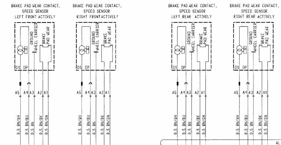

I traced the wires from the actual brake pads to where they plugged into the harness.There is a single wire that runs from the harness to the brakes and it runs in series from one pad to the next at each wheel. My guess is the wire is broken somewhere in the car harness.
Is there a wiring diagram I can get for this circuit? I've checked the pads and sensors several times and they're in good shape. The break has to exist somewhere else and I'd like to track this down and resolve it.
