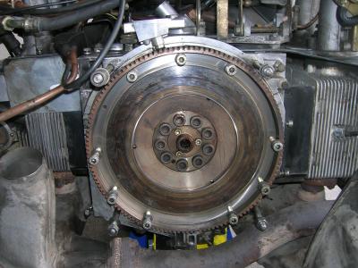

Thanks Loren - should have checked for a reply first before updating. The old flywheel doesn't look anything like the 930-103-233-01, but rather the 03 version. Am enclosing a picture of the old one (both sides) which to me makes little sense overall. The starter which worked with the old one, will not engage the new one at all - have even swapped it out with the same problem of the bendix pushing forward, spinning, but not turning the engine over. Bench tested it as well and both old and new starter have the requisite kick and spin. Looking at the teeth they seem shallower than the old flywheel.
As an aside, the engine number is 64G01144 and the transmission number is 74G01338
First two pictures are both sides of the old one, last picture is new one (transmission / clutch side). The front of the two are distinctly different. and the part number on the back of the old one, isn't the same.
post-49895-0-88734000-1300461215_thumb.j
post-49895-0-91893600-1300461275_thumb.j
post-49895-0-24099900-1300461290_thumb.j

Thanks Loren, Am researching the old flywheel numbers I have found and have to clean up the rusted numbers to be able to read them right. I'll post what I find. My alignment question was aimed at whether I could have a misaligned transmission to engine which could have the knock on effect to the starter as it's mounted to the bell housing. I'll post again with what I find. Thanks.
Well after all the efforts, rechecking all the numbers, the new and old flywheel have the same 930-103-233-0R on the back, although they are delivered under a 930.103-033-01 from the dealer - very odd I think, but. In the end the problem stemmed from failing to reapply the ring gear to the pressure plate (simple as that). Completely missed it obviously when reinstalling the new clutch. I had thought that the starter engaged the flywheel but guess that's only for the sensors at the back. Problem solved, and engine started instantly. Lesson learned about deliberate and slow process - don't let adrenalin and being anxious to turn that key again deter you.
