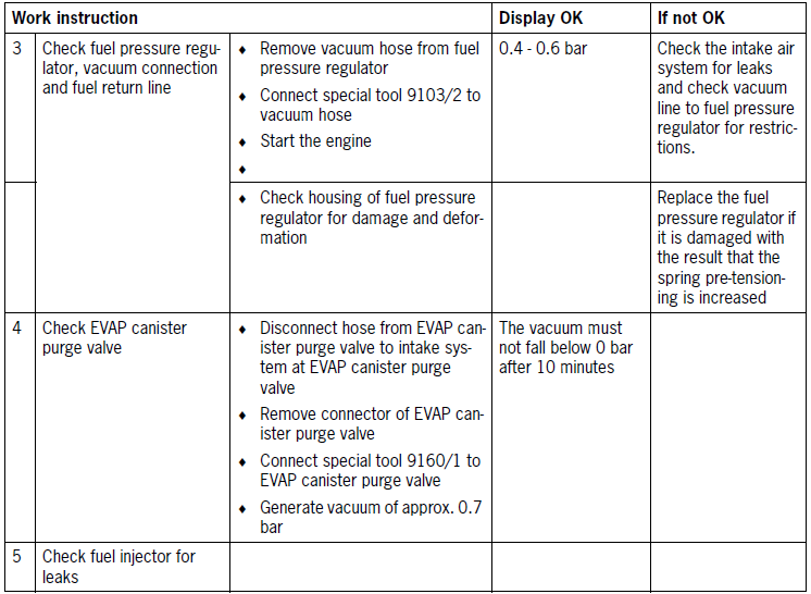

Did the fuel pressure regulator get damaged? Have you measured the pressure?
Sorry about the newbi question but Where is the pressure regulator located??? and how do you test the pressure?
What would be a good / normal pressure on a GT3
NOTE: it runs very good cold.
Pressure regulator is at the end of the fuel rail.
