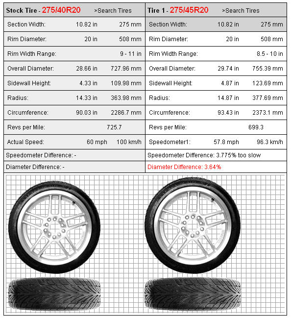

i need help, in my Country is dificult to find tires sizes and good quality, and i have on my 04 cayenne turbo 275/40/R20 and i only find 275/45/R20 you think i going to have any problem with this sizes of tires? can i used this tires? im not using the tire presure sensor.

I just searched for you and this discussion has the tire-size difference calculator. See attached pic for your info. Your speedo will be around 4% too slow. Depending on how you drive and if you go off-road (and if you have air suspension which I think you do because you have the Cayenne Turbo) you'll need to consider internal wheel-well issues such as scraping but overall I think you'll be OK.

I did it. I went from 275/40/20 to 275/45/20. The ride has a little more cusion with the higher sidewalls but the handleing has suffered slightly. If there was not another option I would probably not do it again. I also went with the nexen rodian for cost but the continentals were MUCH stickier on the road but wore out faster. Also, when I pass the police radar that shows the speed you are going my speedometer and the radar are both the same.
