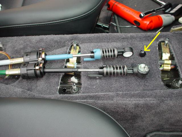

He took the clip off (or it wasn't there) that holds the reverse cable connector to the white plastic block. For MY04 a different cable and connector is used as the C4S has LSD. PET shows a special clip only for LSD cars.
Is it this part or something that looks like it?
Yes I think that's it... Not sure if I had it or not bc i've never seen it.. But c4s stated that something is suppose to go in there.. How is that held in place? bc when I tried to pop it out I heard a "Pling" like something snapped off but didnt see anything fly hahahha I'm gonna look for it but chances are its lost..

I found the problem--In Toolpant's picture you can see that the black plug (which I have) fits into the white sleeve inside the black ring end of the left cable. I had mounted the cable end 180 degrees the wrong way, so that the white part faced against the outside gear housing. That way the black plug could not lock the cable in place, and it kept slipping off (It fell off on my way home tonight and I had no reverse and weird shift linkage!). When I finally got home and took everything apart, I figured it out, and it works! The cable can only be attached in this way, so you have to be careful to have the white liner face out before you push the plug in--it then locks in place, and requires some force to snap off.

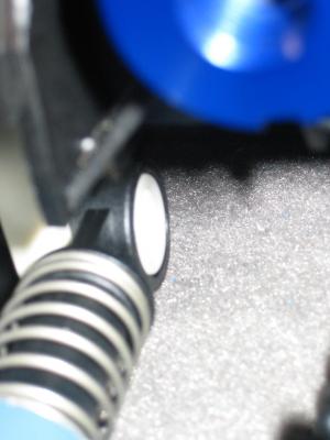

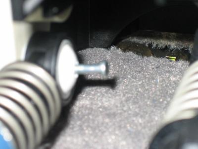

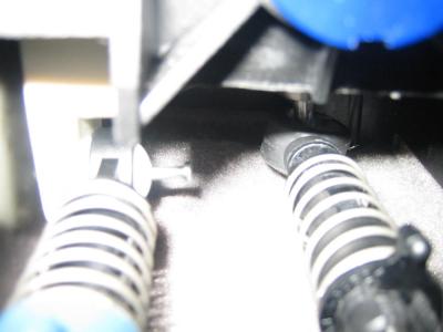

Mine can be put on both sides.. If I rotate it 180 degrees I could still get it in place.. I think I lost my black cap... take a look..
I do I do.. So that's what that "pling" sound was.. :) I didnt see anything fly out so I didnt think anything of it.. Geesh, what piece could be anywhere in the car or garage floor for I had both doors wide open.. hahahaha Is that retaingn clip held on by a pin or spring? Would it have had enough force to pop out at that velocity?

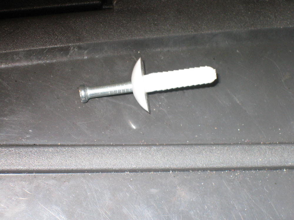

The all plastic keeper has a shaft with a barb on the end so that it is not supposed to pop out. You must have pried the cable connector off so the keeper went flying. With a thin blade you remove the keeper and put it in a safe place so it will not get lost. :P Then the connector just pulls off.

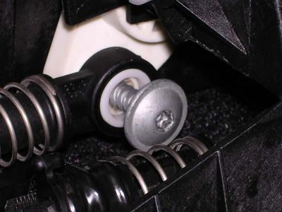

I do not know if you can buy just the keeper. You might have to buy a connector to get the keeper. I would have to ask the parts department if they have a connector and if a keeper is in the bag. Or, you can do what Evan from FDV did as you can see from his picture, and use a metal screw instead of the plastic keeper. In his picture the screw has not yet been screwed in all the way.
