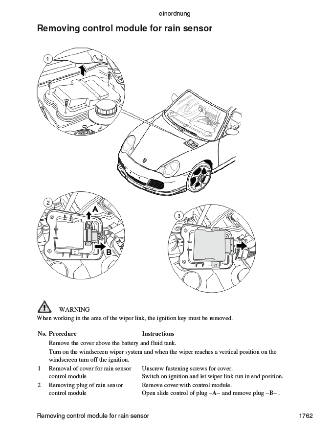

If you notice in the schematic the wiper motor control goes through the rain sensor control.
I would check the rain sensor. Also the intermittent wiper relay and dash switch might pull the circuit down if they are not functioning properly.
