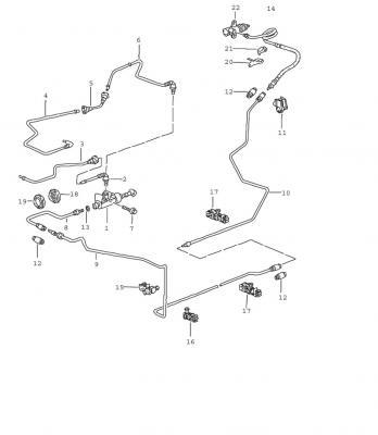

So I found the problem to be a leaky connection between the line coming off of the slave, and a connector. Its synonymous with parts 14 and 12 in the 996 parts diagram (sorry I couldn't find one for the boxster). I intend to have these parts replaced, but am having a bit of difficulty locating the part # and a seller. Again, the picture is for reference only, does anyone know the part numbers and possible distributor and cost for a 98 boxster? Thank you
