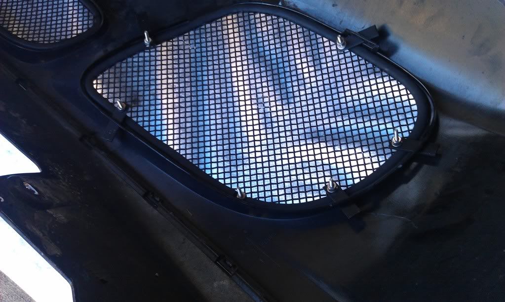

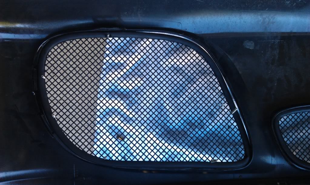

I must say, I am actually disappointed in their fit. They do not fit the grill openings very accurately. They will work, and will look better when the bumper is mounted, but I'd give them a C- grade for fit.
As you can see, the initial fit was terrible. Once tightened up, it gets better, but still not perfect.
The method of attaching them is even worse and they come with no instructions at all. I couldn't even figure out how I was supposed to attach the center grill at all. The side grills come with bolts affixed to the grills. You then insert scrap metal tabs into the OEM grill retention slots and then tighten them to the bolts with supplied washers and nuts.
Here's the final look of the side grills

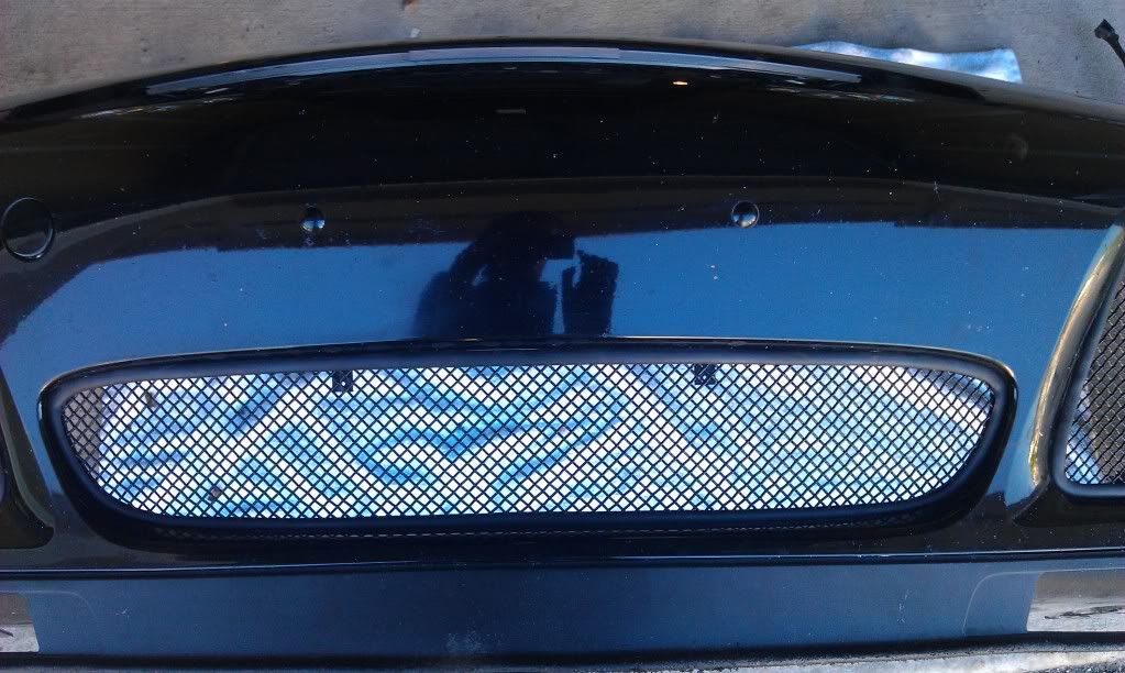

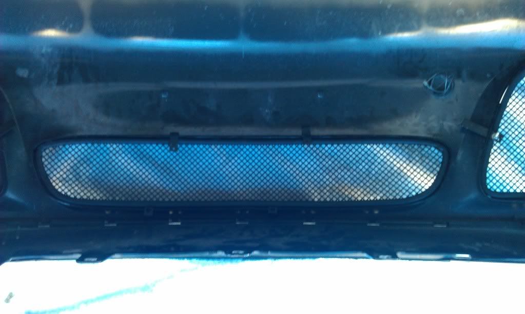

The center grill has NOTHING to attach retention brackets to. The brackets supplied are L shaped and they give you 1/4 inch silver phillips head screws and longer 3 inch black phillips head screws. It looks almost as if they wanted you to drill holes into your bumper cover and screw them into the plastic!? Not going to happen. The screws would go THROUGH it! I just jerry-rigged the center cover by slotting the lame L shaped brackets down in the slots without affixing them to anything. This is actually good enough to hold the bracket in place, but is pretty stupid if you ask me.

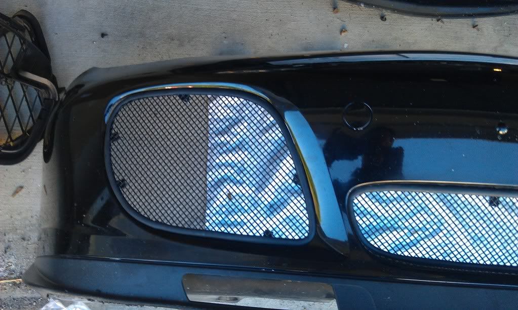

Another problem with these grills is the fact that you can see the big, silver structural bumper support through the side grills on their upper, inner corners. The plastic OEM grills have a solid piece that covers this. I may have to fabricate a cover for that corner or paint the metal support.
I'll post final photos when the bumper comes back painted and on the car. Hopefull it will look better mounted, otherwise, I'm taking them off! I can't believe that there isn't a better option than these. The only others are the Zunesport grills, that actually, may be far better than these.
P.S. Just checked Zunesports site and while the fit seems to be much better there, you can also see the bumper structural support member with them as well. Looks like no aftermarket solution is perfect. I'll fabricate a cover piece myself and show it when the bumper is remounted.

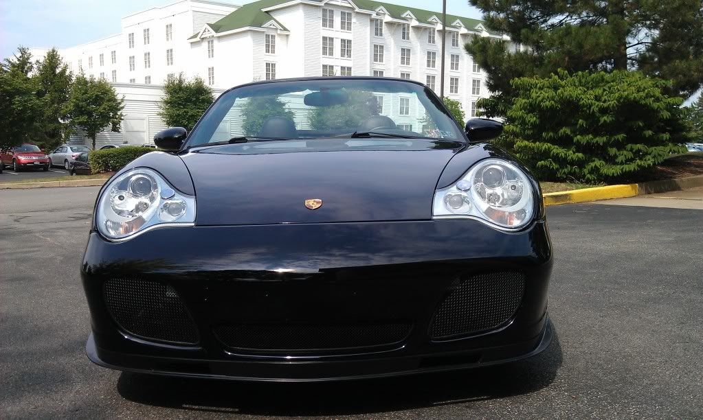

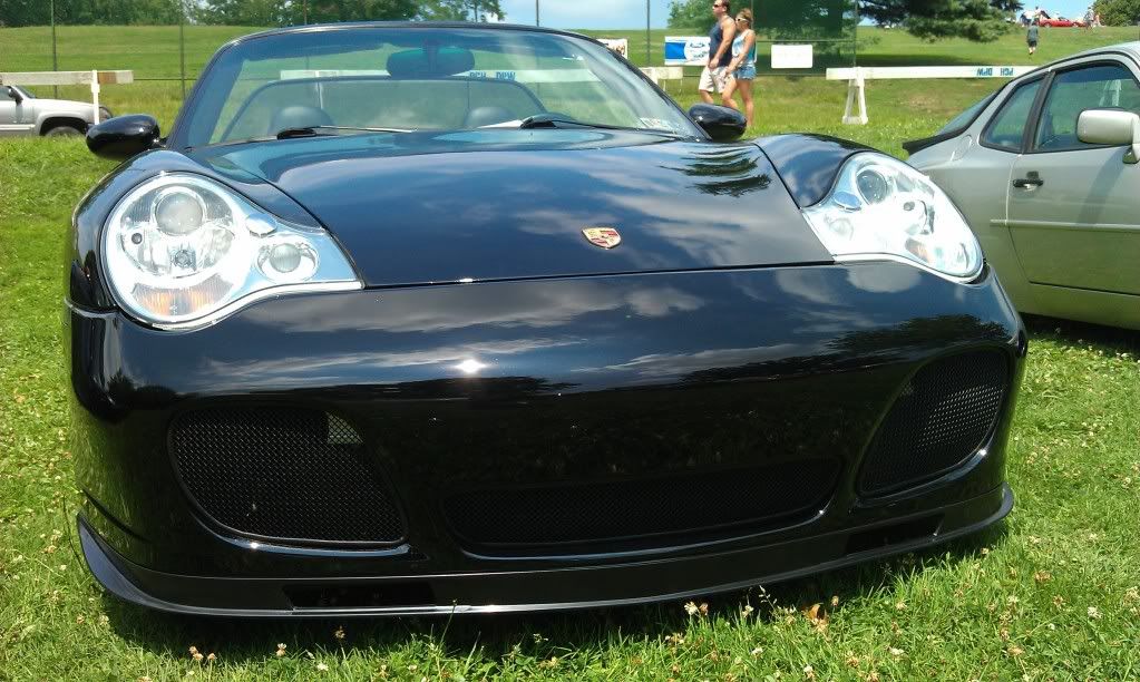

Yes, they're the Mina Gallery grills. Here is the finished result. Obviously, they look alot better when the bumper is mounted.
In all, they're not as nice as I would have hoped, but you really have to know what you're looking for to notice they don't fit as well as they should. For now, I'm leaving them on until I see if I can use the OEM grill frames to fabricate my own.
